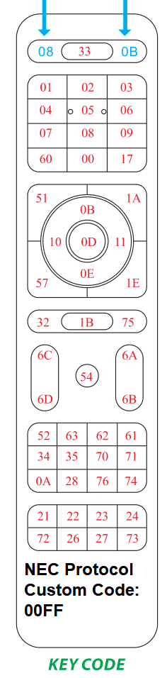

    If the above is true, then apparently the ZVOX device fails to reject the wrong IR codes.
    Formuler RCU data:

    The engineers provided me with information that can possibly help you.
    Formuler devices are programmed to respond to 2 sets of NEC "Custom Codes"
    The Custom code programmed in your Formuler remote is "00FF"
    The alternate code you can use is "02F9"
    Using 02F9 as the custom code in the Harmony remote will make sure the signal is not picked up by your soundbar when the signal is blasted out.
  • Unfortunately I returned the Logitech Harmony 665 IR remote since it was presenting the same issue.
    Is there anyway to reprogram the Z7+ remote so it uses the 2nd set of codes?
    Thank you for asking the engineers about this issue.
