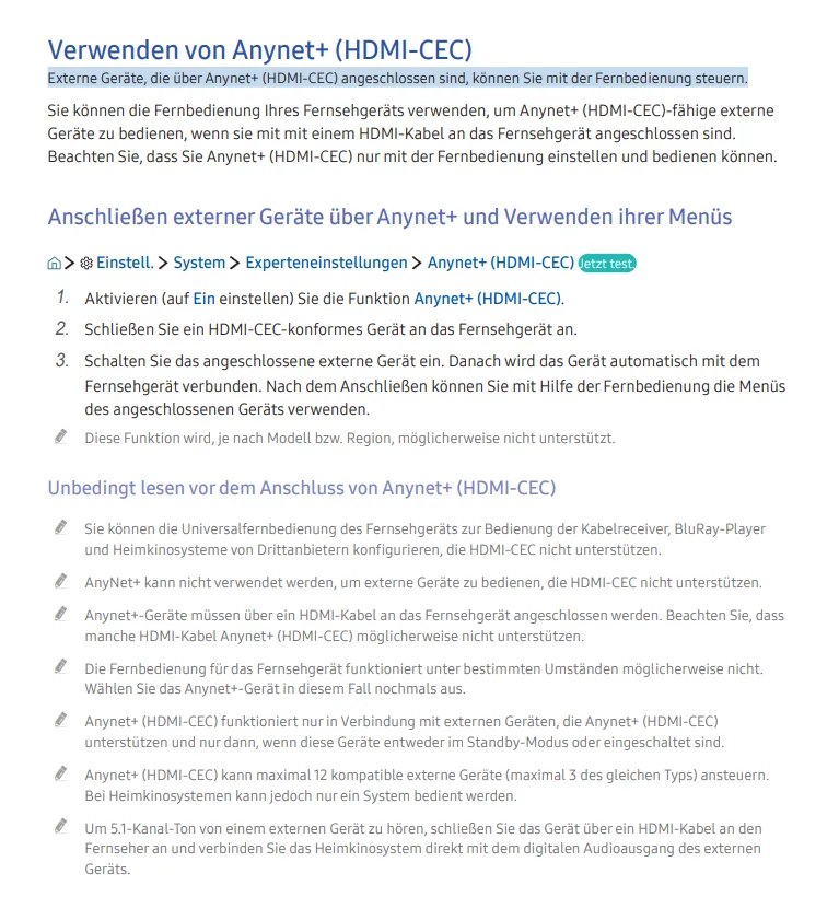

  • Hello. My z8 does not work with the hdmi cec function. Do you have a solution? I've already changed hdmi cable, and nothing. my tv is Samsung UE55KS7080UXZG. Thank you
    http://downloadcenter.samsung.com/content/UM/201…VBEUK-1.1.3.pdf
    page 67
  • Thanks for the answer, but really I already have it active on my tv, it has always worked with other box, including the formuler Z7+. only with this does not work.
