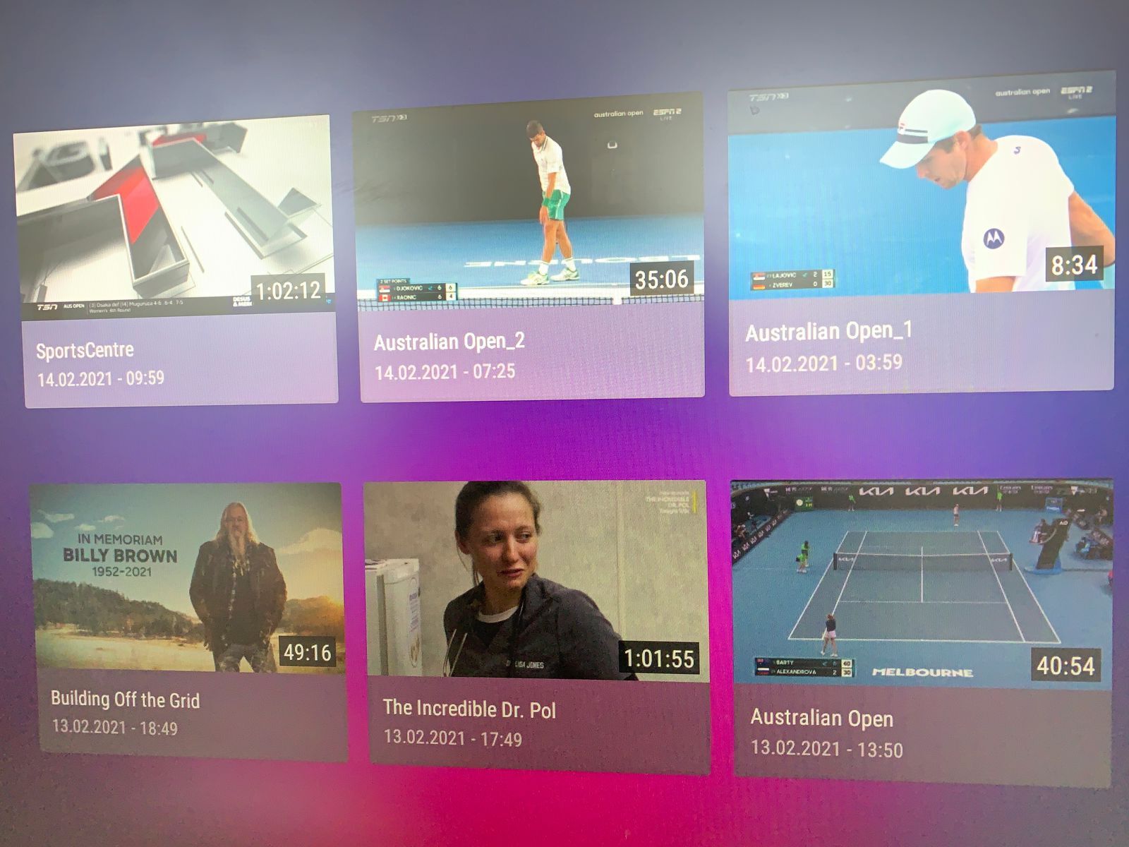

  • I have a GTV with all the latest updates (as of 2021/02/14) that will seldom record a show to completion. This happens for both "live show" recordings (i.e. push the RECORD button) and from scheduled recording.
    I have tried both a (1) 32GB Kingston Datatraveler USB3 stick, and a (2) 4TB WD My Passport USB3 HD.
    I cannot see any specific similarities between the failed recordings -- in other words it seems random. What recordings there are are fine up to the point of failure.
    Both devices check out fine on a WIN 10 Pro system. Both devices are formatted on the WIN 10 system as NTFS.
    Anyone else having these issues?

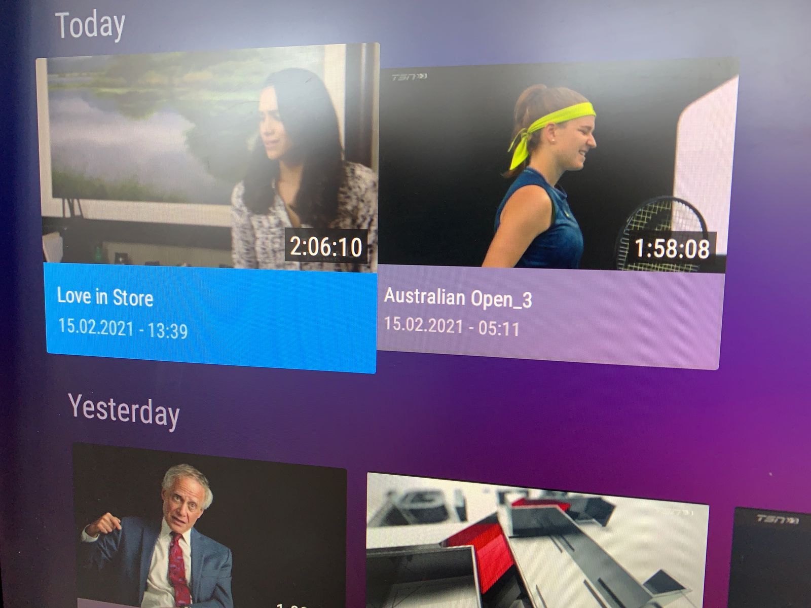

  • One final test (controlled; no operator intervention) seems to indicate that the recording function is working fine.
    In the attachment, the right (1:58:08) recording may have been screwed up by me so I reset and entered a scheduled recording of 2 hours and shut the GTV off (standby).
    It recorded it perfectly (left recording); 2 hours + 6 minutes (for the Extra Recording Time).
    Consider this issue SOLVED. :thumbs_up: :smiling_face:
