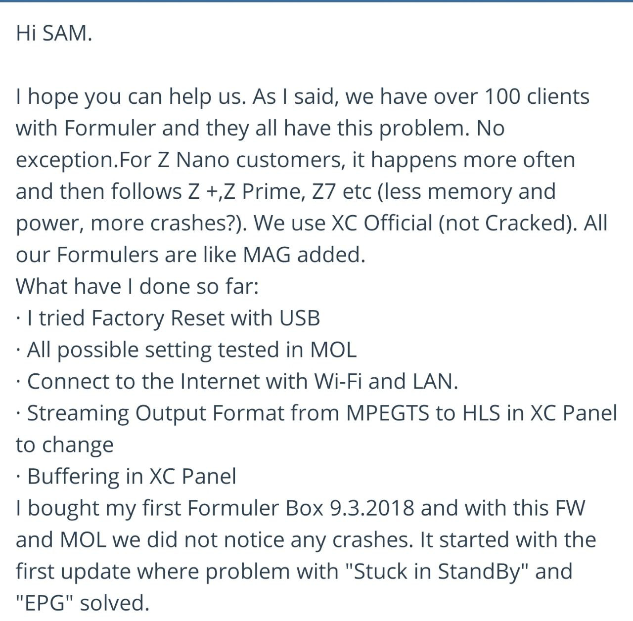

hello, i have the same , i found in another topic the same problem " Connecting to.."Portal" PROBLEM!! "
but there is not the solution, thank you
is not the black screen, if you zapping between the channels just in boxes with mytv online 1 , it goes to dashboard

I have exactly the same problem as described per this user, factory reset didn't help. I believe it start doing this after the latest update.
Is someone able to help me?
I can give more information if needed. Thank you guys. -
I can give more information if needed. Thank you guys.Hi,
did the issue occur on Z+? please let me know which model the issue occurs
Thank Jennie for the reply.
Yes the issue still occurs in the Z+. Its being happening since the last update the HOTFIX 2.0.10 (I believe, not sure exact number but it is the lastest for sure).

Thanks for the information.
Code<img src="https://www.formuler-support.tv/attachment/2421-ficheiro-000-png/?thumbnail=1" class="woltlabAttachment" data-attachment-id="2421" id="wcfImgAttachment0">the problem is in mytvonline, in series z with mytvonline, many customers complaining, it even appears with the date of manufacture 10-05-2021, when this box is with me for more than 2 years.Hi,
Thanks for the waiting.
The issue was patched in the latest BETA software.
If you would like to test the BETA, please follow the instructions below:
- Open the Software Update app
- Press 0227 on the remote
- Download and install the available BETA software
- Test the issue again and let us know the result.

it may not be free of issues, but the preliminary tests were very promising, as I was unable to reproduce the reported bug, using the beta update.
Thank you for your commitment to the issue. -
Thank you for your commitment to the issue.Thank you for confirming that the issue has been resolved.
