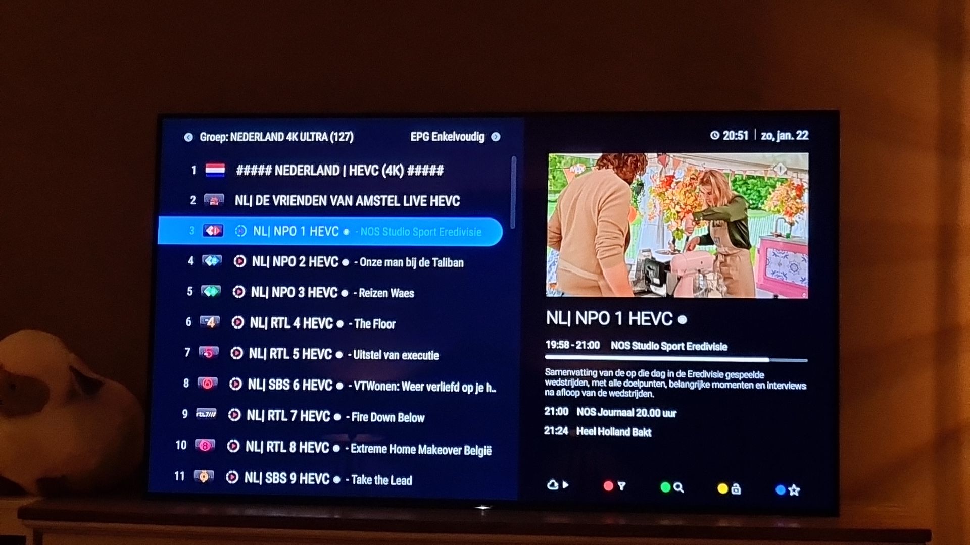

  • Experiencing the same issue, setting EPG to UTC doesn't solve the problem for me.
    When I set EPG offset to 0 and EPG to normal, EPG data in the 'Guide' mode and the EPG channel mode (press "Right" when the info bar is visible) the times are correct. However, when I switch channel, press 'INFO' or press "OK" on the remote control, the program info differs 2 hours from the EPG.
    Tried several offset settings (Normal, UTC, several offset values), cleared EPG cache, then (after the EPG data is loaded again) I get various results:
    EPG Normal:
    EPG Guide OK, EPG Info OK, Info -2hr
    EPG UTC:
    EPG UTC, offset +2hr:
    EPG Guide OK, EPG Info +2hr, Info OK
    There seems to be a difference between the EPG of a channel, the EPG in the Guide and the Info (program info in channel list and program info in the info bar).
    I have 2x GTV's where this phenomenon occurs.
    Any way to fix this?

  • But if it be from source it has to be fould in guide and channel list epg. Its same source. The strange this is when i delete epg cache it is both ok. After 1 or 2 minutes the channel epg changes back - 1 hour and guide stays good. Also at channel epg and then epg single option is in gppd sync so only channel epg is going back 1 hour. Thats strange is't it?
  • Yes i know. The strange thing is that when you do epg database reset its good and after a short time the channel epg is going back 1 hour. The guide stays ok

  • What i found is when i put time back to normal settings so automaticly and time zone +1 in Android box settings.
    After that in mol2 i set offset +1 (netherlands?) and putt of the catchup in grid it works like a charme. So there is a sofware fould with this function.
