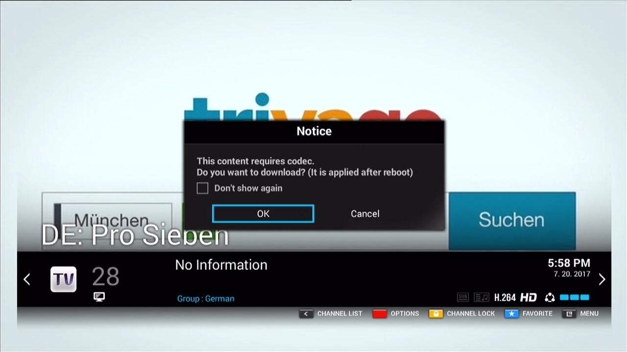

Steps to solve the no-audio issue:
Make sure you downloaded the external audio codec when prompted. (See the attached image)If you don't remember seeing the codec download window, or you cancelled it by accident and selected the "Don't show again" checkbox, you must reset your user preferences to make the codec download popup appear again.
MYTVOnline >> MENU >> [lexicon]SETTINGS[/lexicon] >> User Preferences >> Reset to Default...If the above steps don't work, please show us the Audio track information:
MYTVOnline >> zap to the problem channel >> OPTIONS (RED hotkey) >> Audio Track
(See second attached image) -

In kürze werden Updates erscheinen, für My TV Online als auch Firmware. Bist du dem Vorschlag von 175n gefolgt und hast Codecs Installiert? Das aktivieren des pop up Fensters bei fehlenden Codecs ist schon sehr wichtig.
