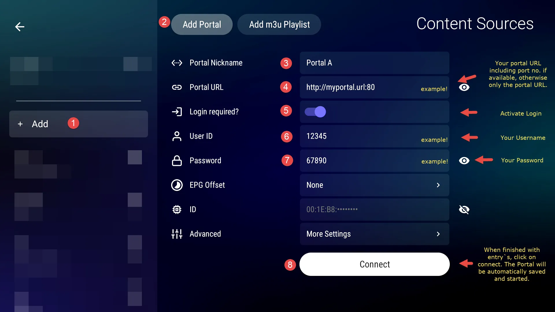

How to create XC API Portal
1. MOL3 Menu -> Content Manager -> Content Sources -> + Add -> Add Portal -> follow the how to on picture.
2. You got from Provider only the M3U Url?
For example it looks like this:
http://myportal.url:80/get.php?username=12345&password=67890&type=m3u_plus&output=mpegts
or
http://myportal.url/get.php?username=12345&password=67890&type=m3u_plus&output=mpegts
For XC API Portal needed data you can extract from M3U url:
http://myportal.url:80 or http://myportal.url
Username:12345
Password:67890
3. Other Solution how to create XC Api Portal too: You create Playlist, type the entire M3U URL and MOL3 will ask you to create automatically XC Api Portal, confirm with yes.
