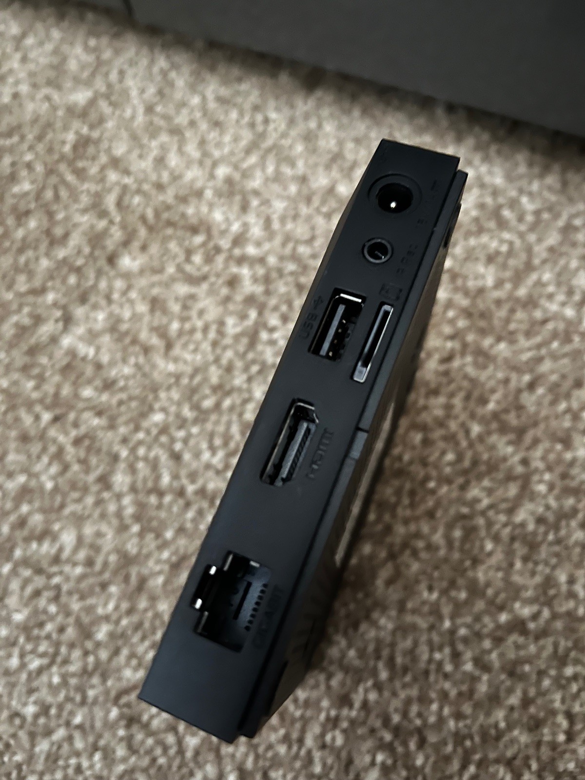

Can anyone help as might be being daft but cannot see where I’m supposed to find the reset button on my unit. Please see photo, looks different to the video tutorial?
Hard Factory Reset Z11 Pro Max?
- Z11 Pro MAX
- Hardware
chrishell76 -
August 14, 2024 at 7:22 PM
Right next to the powerbutton.
Push it in with a paperclip and hold it.
💡 [Built-in Method]
- Connect HDMI cable to Z11 Pro (Max) or Z10 Pro (Max) and TV
- Use a paperclip or similar to press the recovery button inside the IR ext. port
- Hold down the recovery button with a paperclip and insert the power cord
- Hold down the recovery button until the Z11 Pro (Max) or Z10 Pro (Max) logo disappears
- Take out the paper clip and select Wipe data/factory reset on the system menu
- Select Yes then it will take you back to the first screen. Select Reboot system now.

Right to the powerbutton.
Tried that and don’t feel any clicking like there’s a button there and also it didn’t do anything when tried either. How far down do you need to press?
Till end. Till you feel the little "click".

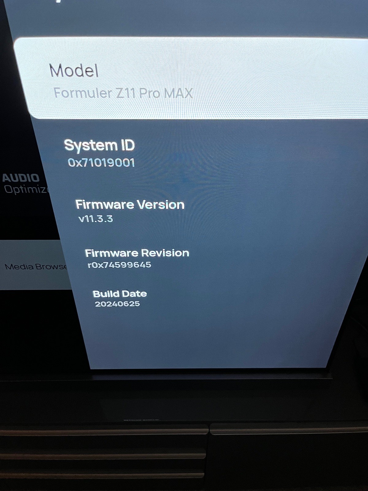

Do you have a formuler z11?
Not other brand/model?
More pictures otherwise. Reset should be there if its original.

Z11 Pro Max
Z11 Pro Max
Looks original to me.
Reset should be there.
You can also factory reset from android menu my friend. I see you are on the menu so you can also factory reset true androidmenu

hello friend. It is quite tricks to feel it. You should fel a click button inside the hole.Feel yourselfe around in the hole for a microbutton.
Regards, frankie
