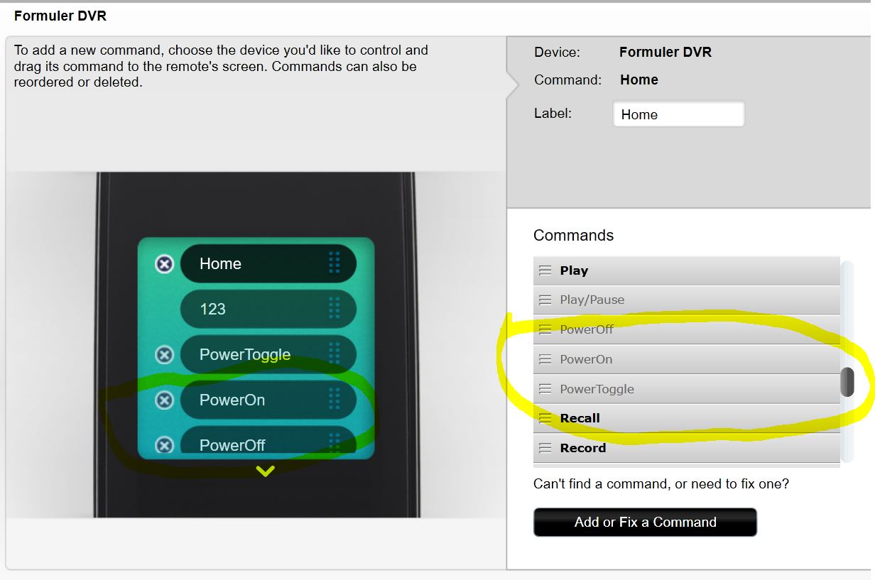

  • FYI the beta that was released today has support for discrete power on and power off codes. Do harmony remote codes need to be updated?
    yes. if someone has a line of communication with the Logitech Harmony team, please PM me.
    The new codes must be added to their database.
  • Let me know the new codes and I'll have the Harmony team update the profile. Note that anyone who already has the current profile installed will need to delete their device and re-add the profile once Harmony has updated on their end.
    New codes added to the firmware:
    Code
    sleep - 0x8c73f902
    wake up - 0x8b74f902
    Format is LSB, but I'm not 100% sure how this should be expressed in human readable format.
    Please try:
    Code
    Protocol: NEC
    Custom code: 02F9
    Sleep:
    Keycode: 73
    Wake Up
    Keycode: 74
    If that doesn't work, let me know and I will provide some alternate codes.

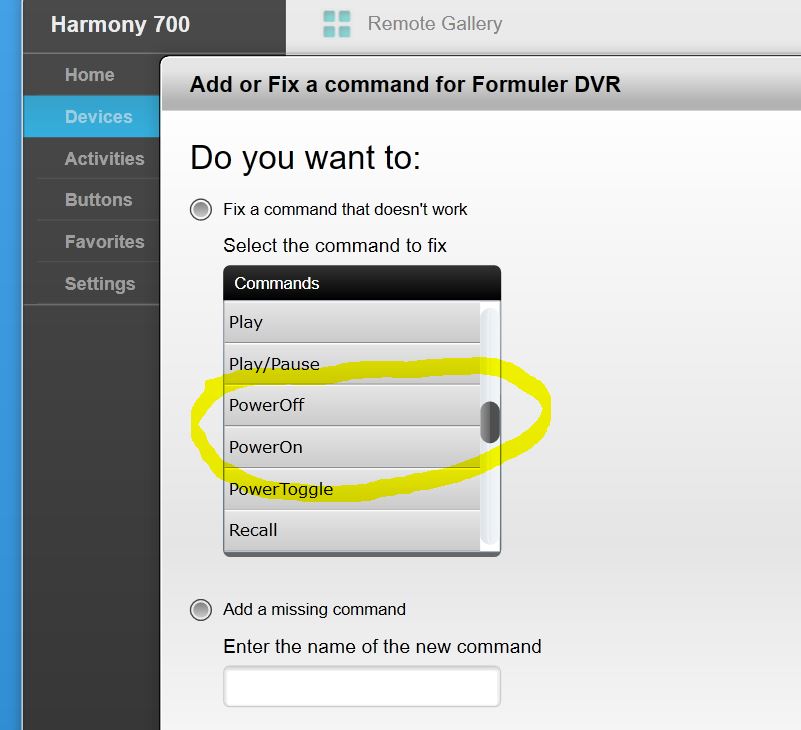

  • Just just got confirmation back from the Harmony team that they have updated the profile. I'm actually out of town for the next couple of days, so can someone else check to see if these two new commands were integrated, and that previous commands have not been negatively affected?
  • can someone else check to see if these two new commands were integrated, and that previous commands have not been negatively affected?
    I just deleted the Z7+ from myharmony and readded it. Unfortunately there is no discrete on/off or sleep/wake commands.
    I tried adding a Z7 (not +) and it has a sleep command but that just sets the box's countdown-to-off function. I did this on a Harmony Ultimate (touch) and an old Harmony 700.
