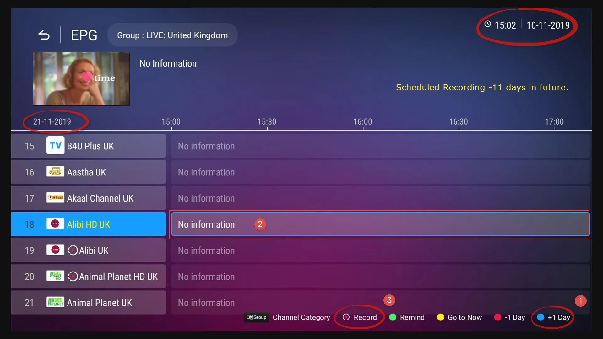

1. Open MOL2
2. Open the EPG
3. Select the channel you want to record from
4. Use the blue button (= +1 day) until you have the date on which you want to create a recording

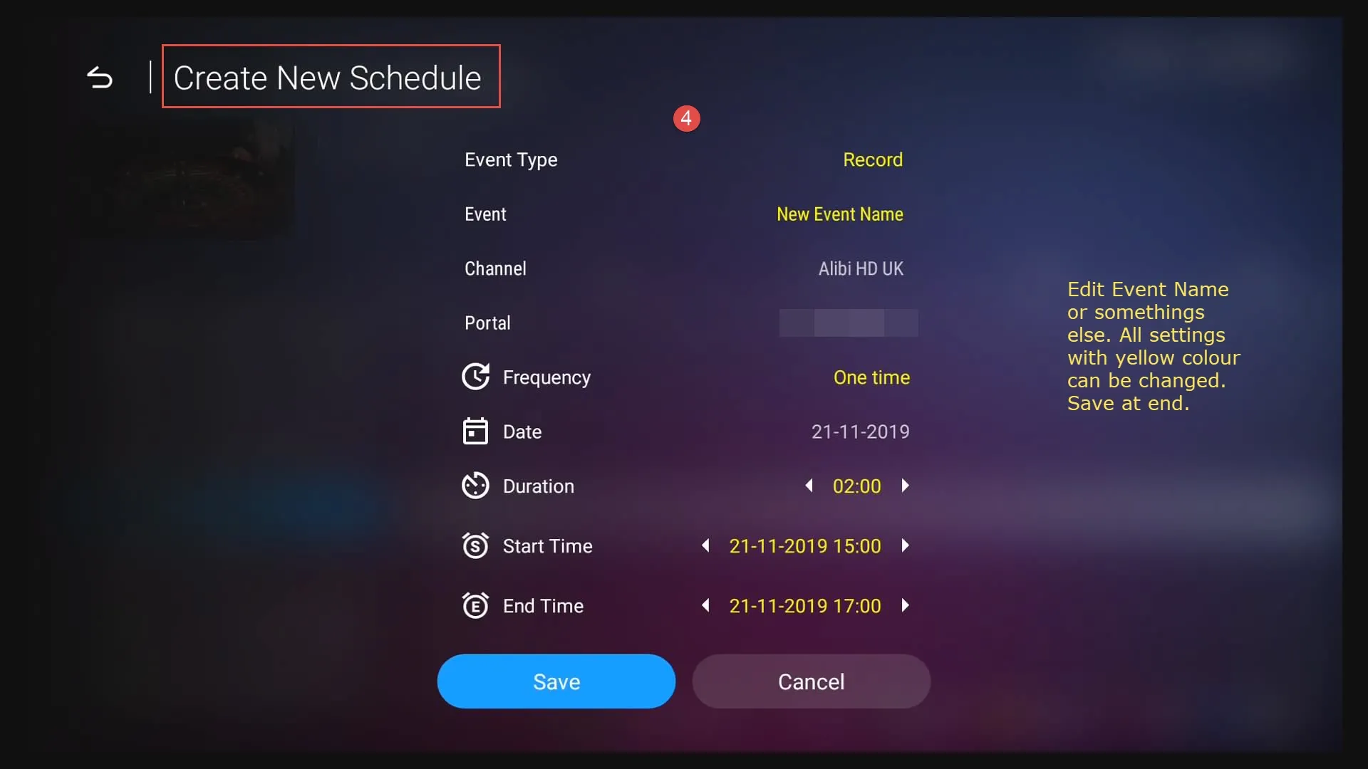

5. Select program in the future (if not available > select "No information") > Press "OK" on RCU
6. Edit the fields in the "Create New Schedule" screen that appears.
7. Select "Save" on the screen.
How to with scheduled recording with 11 days in future.
1. Open EPG
- Select channel for recording
- (1) Press (today is 10.11) exactly 11x times on blue button to get 21.11.
- (2) Select "No Information"
- (3) Press "record"
2. Edit scheduled recording
3. Set Daily or Weekly if you need.

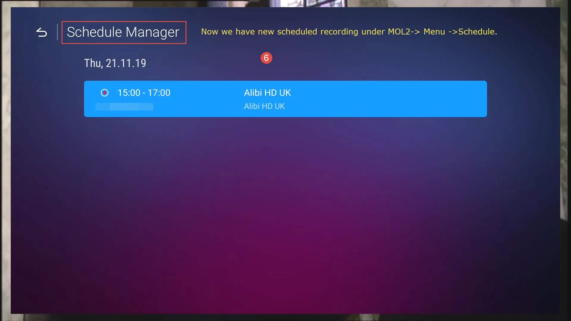

4. Check in MOL2 -> Menu -> Schedule, your scheduled recording.
5. If needed you can there edit your scheduled recording again.
