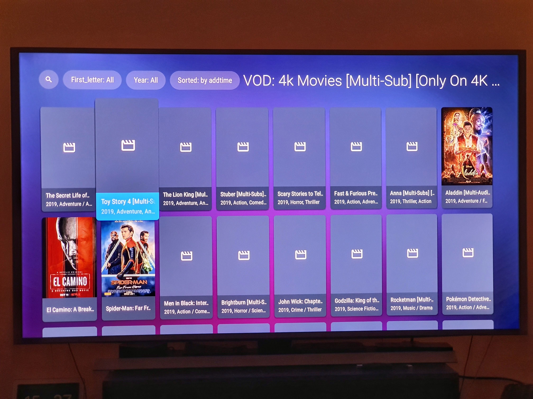

seen this mentioned in another thread, but can't find any solution, pics or thumbnails is missing on most of the vod movies, I have cleared cache on z8 and restarted, but nothing helps. I have another z8 where it works.

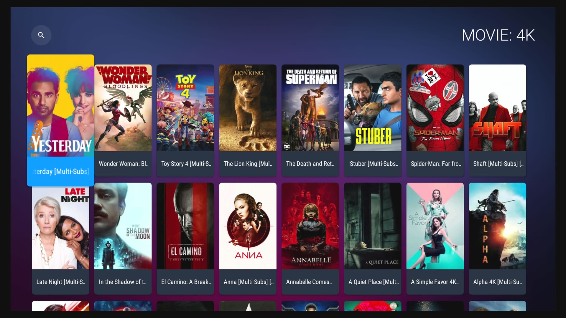

Provider dependent. See picture from 1 Stalker and second from XC Api.

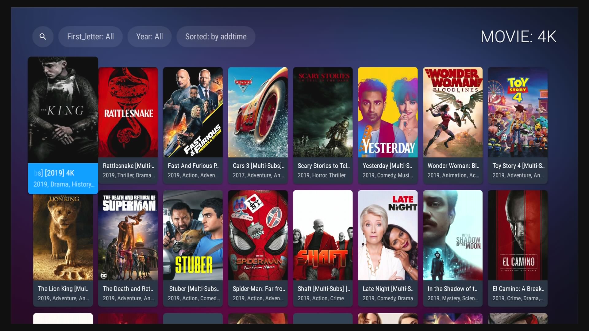

Tested now also m3u_plus url, vod shows all pictures like stalker and xc api connection on same provider.
