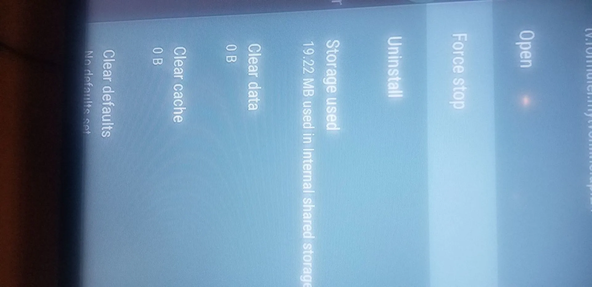

    Okay Cleared both cashe which was empty & now cleared data also.
    Going to close fully down & see what becomes.
    Fingers crossed.🙏🙏
