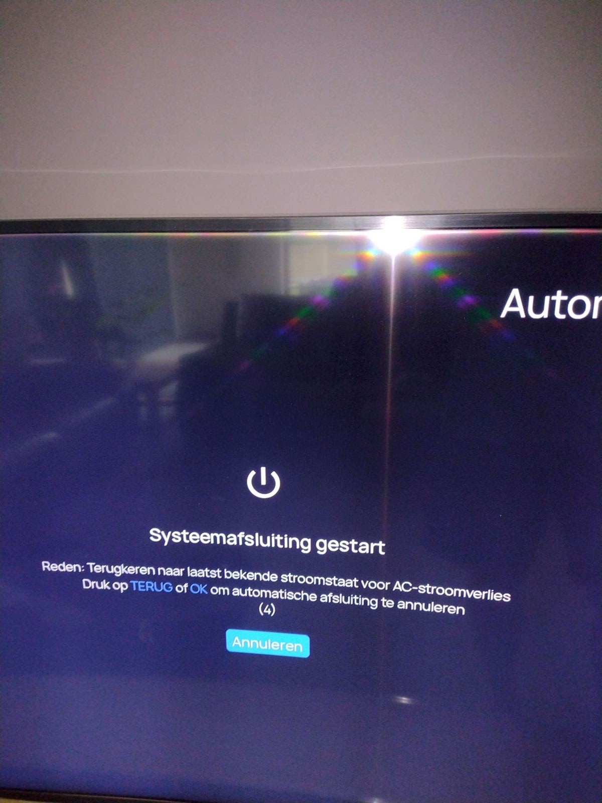

  • hi guys
    I waited a few weeks to post this, but here it is, as this problem seems to occur more and more and starts to get a bit annoying.
    Info: XCAPI, using standby, more providers active, external HDD mounted via usb, external keyboard mounted via usb.
    In more than 50% of the days/mornings, when I try to start, the box does nothing, red light stays on. I think the RC (BT) blinks white then. Always need to cut power to restart, then I get the warning as attached in the photo. Difficult to reproduce, afterwards and during the day, mostly all works fine (going to standby and restart).
    Strange, but perhaps this helps: after this problem: content has sometimes updated and sometimes not, same for the EPG (is on schedule 12h, but is the same with schedule 3h). Any suggestions?
    Thanks and best regards.
  • Picture shows automatic shut-down after power loos. What is the question about this, it is normal behaviour after power cut?
    How is your Box set, Standby or Power Off Mode? Change to Power Off mode.
  • How is your Box set, Standby or Power Off Mode? Change to Power Off mode.
    Hi SAM
    Sorry for the late reply (been away a few days), as stated in my post I use standby. Changed to power off for a few days and this was even worse (it once took me 6 powercable cuts to start up normally in the end). So I changed back to standby, but sill the same problem: I couldn't start up this morning (red light stayed on - already placed new batteries in the rcu). The content & EPG wasn't updated either, but I could do this manually.
  • All described points to big issue, i think OS. Please do factory reset and if possible also replace the power adapter and test again.
