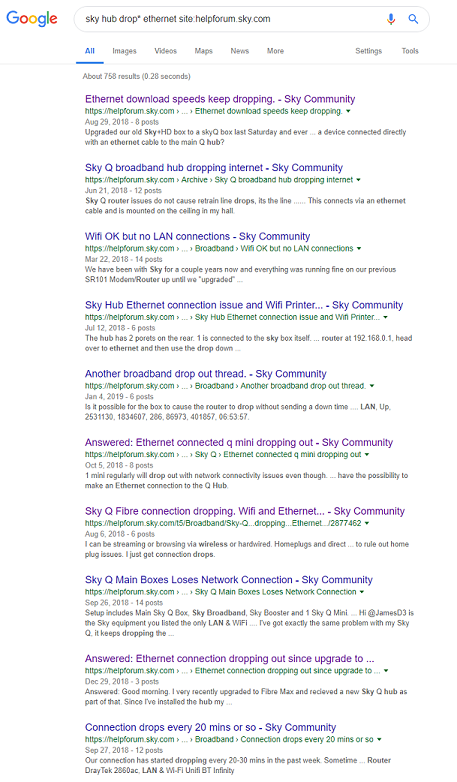

  • This issue seems to be isolated to users in the UK.
    Sky provided routers/hubs have a lot of issues, just check the sky forums and you will see.
    Please try to use a different dedicated router or seek assistance from Sky.
    If you're not from the UK and aren't using Sky-provided routers/hubs, please list your router make/model in this thread.
  • sky q router : try disabling IPv6 LAN side on the router. Type 192.168.0.1 in any web browser
    select advanced tab, log in with admin / sky. Select the LAN IP Setup tab, scroll down and untick "Enable IPv6 on LAN side" and apply the changes.router will reboot
    then connect ethernet cable to box this should give you a wired connection without kicking you off after a few minutes
