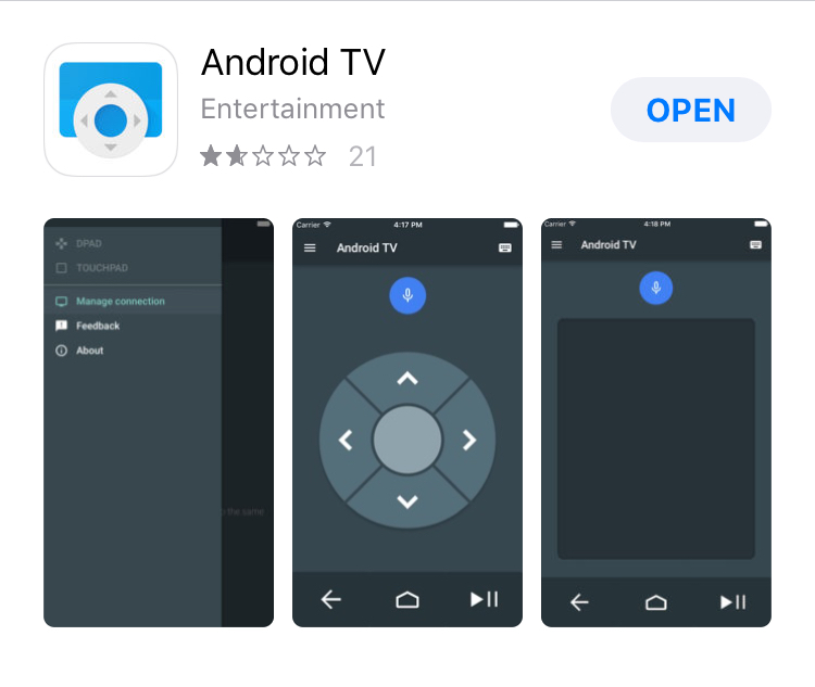

Android TV App works good connects up bluetooth to iPhone 7 immediately. Weird that the iPhone itself cannot pair with the unit

I have been using the Android TV from app store on my Formuler 8 but with my new Formuler z10 max, the Android TV app does not work (app does not find the formuler 10)?
Z8 has mobile version Play Store but Z10 has Android TV Play Store. Which app are you referring to? Google app for Android TV is in Google Play Store for Z10 Pro Max
I am using Android TV ( iOS) on my iPhone. I uses it as a remote but mostly to enter info in the portal. Android TV ( iOS) works with my Formuler 7 and 8 . Android TV app on my iPhone ( iOS) does not find the connection to the Z10 Pro Max.
So there is no iOS remote for the Z10 Pro Max?
I found the issue why I could not connect to the Via Android TV app with my iphone. Go to settings > apps > see all apps > Android TV. I uninstalled the Android TV remote Service and then it worked!

Android TV iOS app doesn't work anymore with z10 pro max. If you do factory reset it works again and then at some point it just stops working again.
No need to factory reset. Try this…
Settings
Apps
See all apps
Systems apps
Select “Android TV Remote Service”
Select “Uninstall Updates” and OK
Back out of the menus and it will work again for the Z10.
I have to do this once in a while when the Z10 disappears from the iOS app.

Do i have to do this on the Formuler or on the IPhone?
Formuler box.

Install Google Home from App Store
