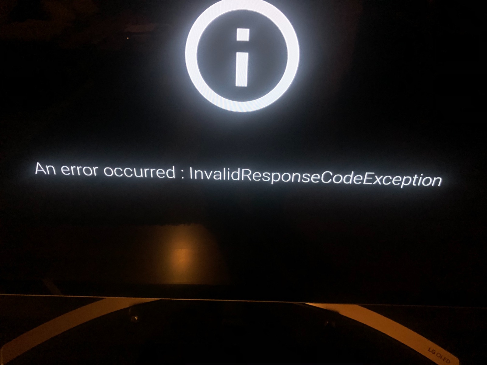

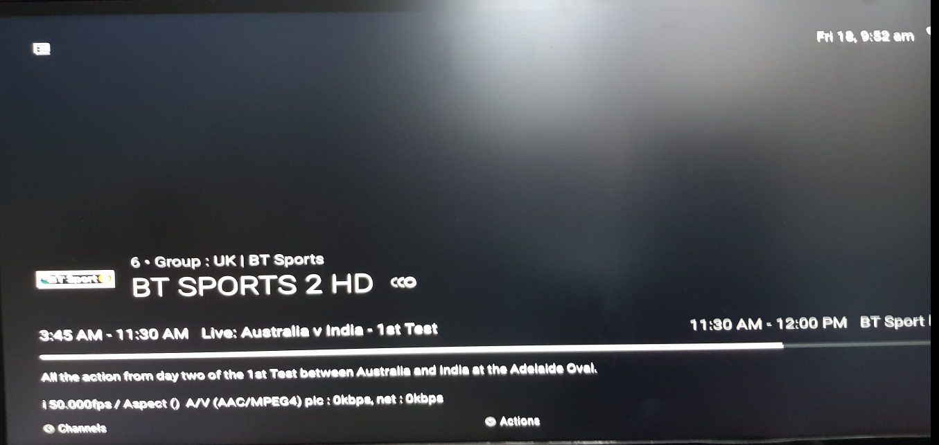

    Z7+5G - confirmed internet connection by switching to live streaming app
    Z8 pro - MyTVOnline 2 info screen attached image
    switched to TiviMate, still black screen error occurred code 403, checked internet speed - 62Mbps.
