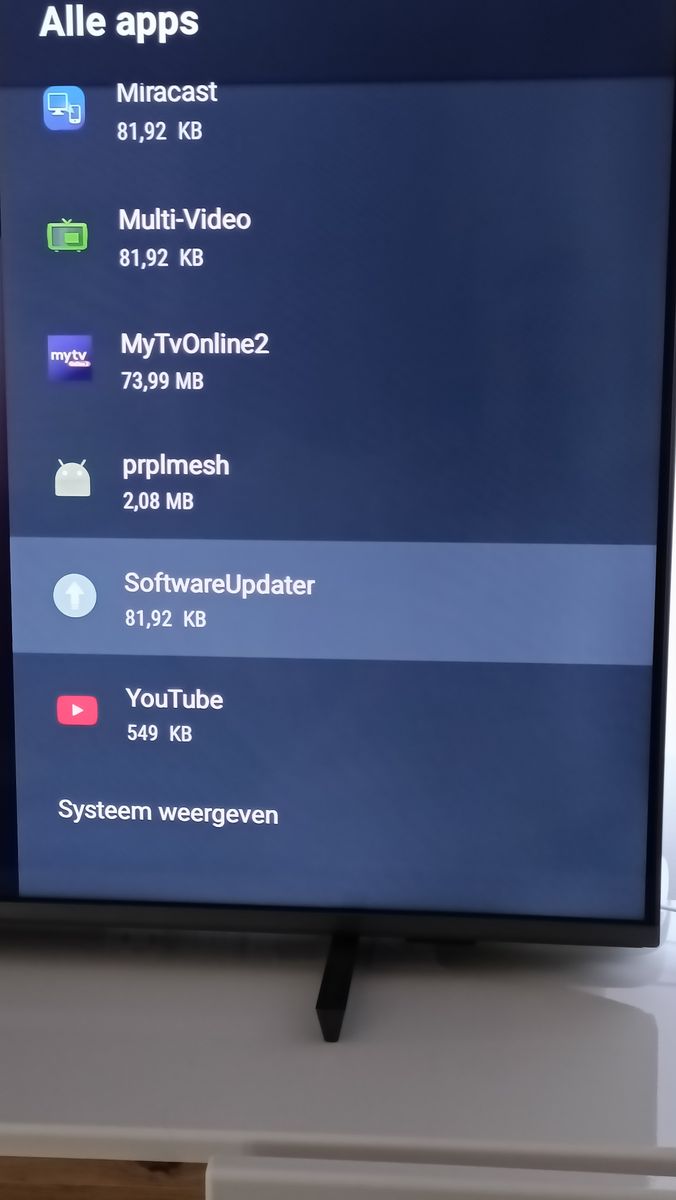

After updating to the latest version i still get the Unable to open stream Server error: HTTP 401. After retrying to connect 5 times i get another screen that says contact your service provider. Have multiple Formuler boxes this is the only one with this issue. I did full factory reset (multiple times) installed everything again but still the same issue. This is a Z10 Pro max box by the way. Is there anybody that could help me out please ? Thanks in advance.
Hi Sam, i've done all that still not enough space, so i unistalled MOL and different updates in the android area, so i had some space available. it's not really normal that i have to do all that with the brand new formuler 10S E.
Tnx for your advice Sam and have a nice easter weekend
I had the same problem like you, on the Formuler Z10 SE
Have to delete a lot, to make enough space for the software updates.
I agree that is not normal, 4GB is simply too small.
If the same channel has no issue on other boxes but only on Z10 Pro Max, PM me for further support.
Because i was afraid of the space with this box and future updates, i send the SE back en ordered the Z10 Pro MAX
There has been a change in Software Update app to create more space in case of insufficient storage before the update install begins.
