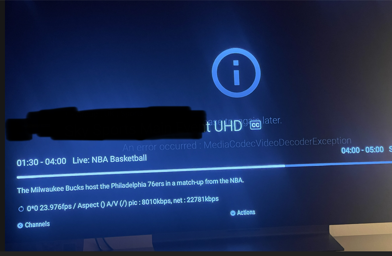

I got the message above when i tried to watch channels in 4K, HDR, etc...?
Black screen on my Z11

Media codec video decoder exception

I have this issue after the latest update…
Is there anything we can do?
Codec infos are needed. Press info button and do screenshot.
Works on any other device apart from formuler z11 pro max.
After the last update…
Checked further on laptilop using VLC for further codec details.
I checked 3 UHD streams. The problematic one (above) has the same properties as the other two streams (which are fine on the Z11 pro max ).
The only video codec property that is different:
Working streams -
Color transfer function: ITU-R BT.709
Codec exception shown on the stream withC olor transfer function: Hybrid Log-Gamma
Not sure if that is related, but it is the only difference that I found. I did set the HLG option from the menu but that did not fix it.

Hve seen this error also on a 1080p channel. Guess it's not just UHD channels.
Just came here to say the same thing.
UHD channels are the same for me. They have been working fine till latest update.
I have the z11 pro max, having the same issue on UHD channel that is HLG and HDR 10.
works all other devices apart from z11 pro max
Same thing happening here since the last update.
Same here, but only on 4k channels since full software updates. Was grand on beta firmware

Same issue. Media codec video decoder exception. Only on 4k hdr/hlg channels. Only since last update. Any info?
Joining the club here with the same error as well.
Edit: same as the conclusion above, HDR 4k channels are affected.
Z11 pro with the latest update, was working on the last beta. -
Issue is forwarded now to Formuler. Thx, for reporting, no need to continue with more reports.

We have identified the cause but need to do a further investigation as each situation may differ. Open a conversation with me if you have this problem.

An update will be out next week. It took a little longer than you expected because we wanted to include fixes for the related issues. Kindly be patient until the hotfix is available.

Just installed latest beta and got UHD back 👌
Beta works perfectly
finally, I can watch HDR HLG again
thanks
