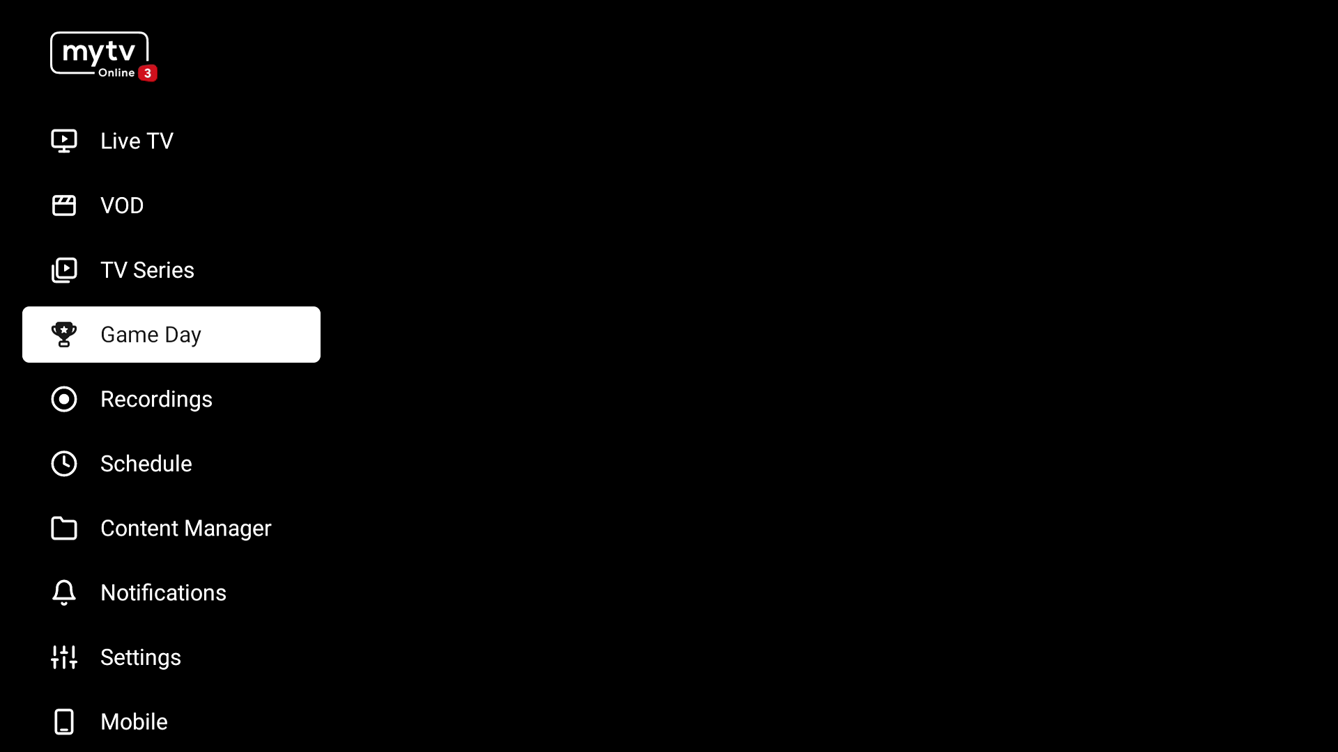

Hi,testing game day now on football,Nations League,as it seemed to work before,now i am getting only failed to load data?
Are you able to reproduce the issue?
If so, please send the logs after reproducing, and let me know the tracking number.
It didn't happen again, normally happens when testing beta updates but whenever happens again i'll send the logs.

No complaints about the update,huge sportsfan and now i only get:failed to load data in game day.
Strangely enough,initially after the update it seemed to work , now NADA!![]()
I did test and this is what I get, if I search for football matches in Netherlands on saterday 19 oct.
But as I say, I don't use Game Day.
Thx,Ronaldjan, i used to get the same,as you show in picture,unfortunately it no longer works.
Why can't you change the sorting mode so they stay where I want it on last uploaded. Every time you turn it off, it goes back to default.
Have you checked again today? For me it works the same as RonaldJan posted which appears correct.
Hopefully yours works and if not maybe uninstall and reinstall MTOL?
Maybe you did the first upgrade, which was pulled back for an error, and later relaunched as SAM did mention.
I did the upgrade after the error was removed.
Maybe you can check that ![]()
Good tip,adrilang,uninstalling MTOL3 and reinstalling did the trick,it now works like it should.I noted that while doing this a software update was in notifications,which disappeared after reinstalling MTOL3!
Strange thing is that i was already on the latest IPTV version v12.1.15
I guess you might be right,Ronaldjan,but it still leaves me with the question,why it initially worked?

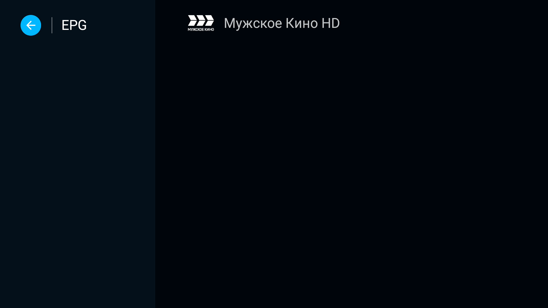

It's strange. so much time has passed and the problem has not been fixed. i provided all the necessary information in PM but it turns out that no one heard me. bravo to the developers of Formuler.
screenshots from Formuler Z10 Pro Max where EPG Single works
and these are screenshots from Formuler Z11 Pro Max where EPG Single does not work
I take it this is not a feasible problem for developers?
Display MoreIt's strange. so much time has passed and the problem has not been fixed. i provided all the necessary information in PM but it turns out that no one heard me. bravo to the developers of Formuler.

I've given you everything you need and I have no idea what or why it's not working for you. the strange thing is that when I sent Staff links to fix the Z10 Pro Max it was working and had the appropriate fixes.
P/s I added you to Conversations where the fixes for the Z10 Pro Max have been made.
