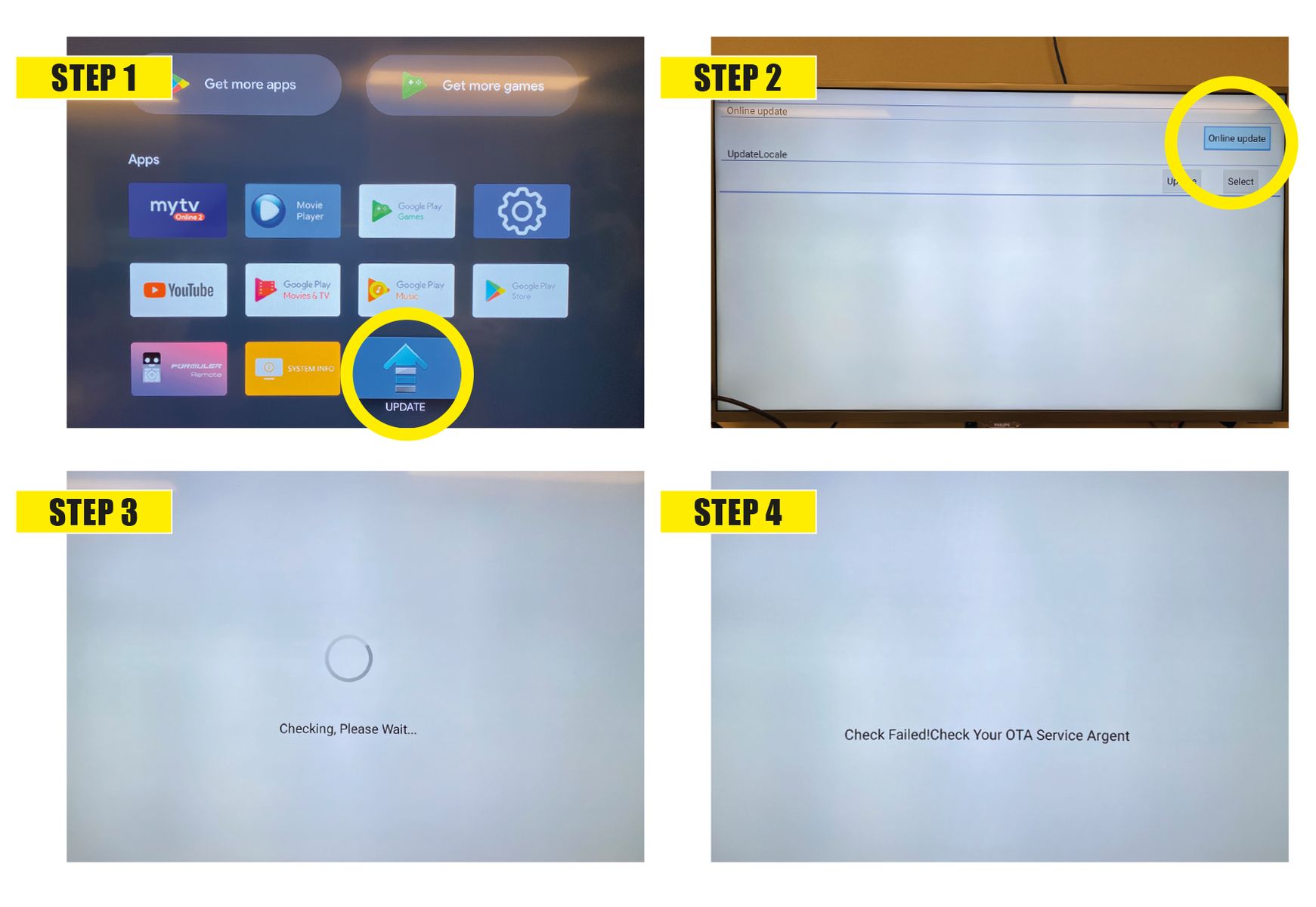

  • Except that this application does not exist, never, even after reset, nor in the system applications (Home> Settings> Apps> See all apps> Show system apps).

  • I can see what is happening on the video you indicate, but I never got it.
    I have already done many resets. I waited each time, but no GTV update notification ever appeared.
    I also tested with a mobile connection, and also on another connection at a friend's house (with reset each time). It doesn't work in any case.
    I seem to have defective GTV hardware. So, I'm waiting for a solution from Formuler.

    Major GTV software updates were ready before these boxes went on sale.
    This is why the first update does a factory update to new software.
    Sadly some GTV have faulty software which does not get this OTA update like the box Damien has.
    He should ask for replacement from his seller.:smiling_face_with_sunglasses:

  • Just a little update for people whom Formuler GTV will not do the firmware/software update to get the MyTVonline2 App running fine.
    It seems that there is a problem with a few Formuler GTV's with the PN number "CBGTV2020801424" (see backside GTV or packing)
    Formuler ask me to confirm if my GTV has that PN number. And Yes mine has.
    I'm going to contact the seller to replace it.
