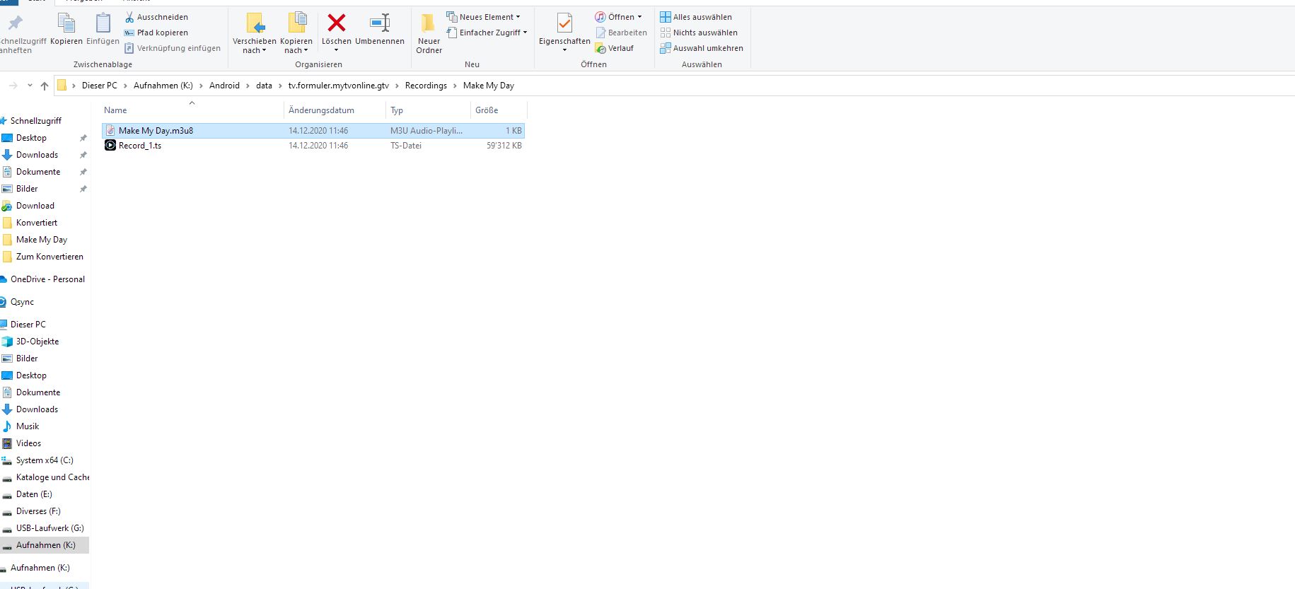

Hi all
I can record a chanel but i can't play them. I receive an error message.
Am i alone with this problem?![]()
Regards Aeffele

I have the same problem.
What error message?
Will look into it and announce later in the day.
I thought there was something wrong with my USB memory so I did not spend much time on it when the error occurred. If I remember correctly, I received a message that the selected file cannot be played.
Sounds like your USB might be incorrect format.

as i said recording is not a problem only to the play them,...
Yes sure, if i have only one line , so i can't switch to another chanel during recording
So I think it's not a USB stick problem , the same stick is working on Z8...
I will send a picture of the error message

Upload the m3u8 and ts file to wetransfer or mega or google drive and Private message me the download link so it can be analyzed
Private message, how?
Here is the download link valid for 30 days, its a copy of the USB stick.
Regards Aeffele
Here is the download link valid for 30 days, its a copy of the USB stick.http://JJBOXTHREE.myqnapcloud.com:8080/share.cgi?ssid=0ViJrTD
Regards Aeffele
Thank you. The developers verified and patched the bug in internal builds. The fix should be available in the next update of MOL2 for GTV.
The current workaround is to set your Android System Language to English
cool, thanks link deleted...
Record is not the Problem
But not possible to watch records with mytvOnline2 veeds othe apps like VLC to watch
With IMxxlayer(seems to be a plagiat of Mytvonline2?) Record and possible and watch the Records possible.Its a shame that a Copy of Mytvonline2 cann mange it but not the Original.
Old Z8 works well
Can confirm that changing the language to english solves the playback problem
Surprising for me it works .Thanks .But the other day I had changed from German to English but Playback did not work.
The mainpoint is not change language in MytvOnline2 to English ! It had to be done in the Configuration of the Box.
So Playback works = Box English MyTVOnline2 = German
